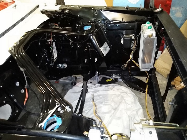

    All of the wiring is in now I have sorted the alternator conversion circuitry (which was surprisingly easy) and relocating the regulator due to the engine oil cooler that the Monte Carlo Rallye cars ran in the day. I just need to finish & wrap the rest of the yellow alternator wires and finish fitting to the clip retainers. Then its on to the battery cable from boot to cut off switch etc. After all of that is done I will fit the battery and circuit test the whole system.
    Important to note that when looking at the cut off switch it is not just the battery circuit that needs cutting off. The charging system cycles 12v from the alternator (or generator)via regulator to the battery but, more importantly, it is on that same circuit there will be one other larger wire that provides power to the entire electrical system plus the generator light wire. (In my car the large wire runs from the regulator to the light switch to power the electrical system)
    So by disconnecting the battery only with a cut off switch may not actually stop your motor as the alternator is still providing power on a running engine, likely sufficient to keep your motor running.

    All of the wiring is in now I have sorted the alternator conversion circuitry (which was surprisingly easy) and relocated the regulator due to the engine oil cooler that the Monte Carlo Rallye cars ran in the day. I just need to wrap the rest of the yellow alternator wires and finish fitting to the clip retainers. Then its on to the battery cable from boot to cut off switch etc. After all of that is done I will fit the battery and circuit test the whole system.
    Important to note that when looking at the cut off switch it is not just the battery circuit that needs cutting off. The charging system cycles 12v from the alternator (or generator)via regulator to the battery but, more importantly, it is on that same circuit there will be one other larger wire that provides power to the entire electrical system. (In my car the wire runs from the regulator to the light switch to power the electrical system)
    Hi Paul, Been following this build on T.R.S. and offer my congratulations on such a fantastic job. As per your comments on the wiring cut off switch , you are bang on re stopping of the engine after alternator conversion. I struck exactly this situation on my Mustang . Initial start up and cam run –in then flicked off the ignition switch only the have it keep going. Pulled the battery lead off and still carried on. Luckily a 4 speed car , so jumped in and stalled the engine to stop it. Was all nearly 20 years ago so have forgotten the exact fix I used , a simple diode in the wiring so it couldn’t backfeed from memory ! Looking forward to seeing this on the road and track. Regards

    Quote Originally Posted by Parnelli View Post
    Hi Parnelli,
    Thanks for your post! Very true and good advice with the Zener diode installation, to stop engine run on for a street car generator/alternator conversion (depending on the OEM wiring configuration).
    I think it goes into the wire to your generator light to stop back run of current when ignition is switched off, as you say.
  13. #453
    I have wired the rear mounted battery cables today from:
    The battery mounted in the trunk to,
    The interior dash cut off switch to
    The exterior cowl mounted cut off switch to
    The solenoid under the hood.
    The battery/ignition current feed wire from the regulator will be redirected to the hot/current side of the interior cut off switch.
    To complete this circuit:
    A New wire will be fixed to the cold side of the external cut off switch and then fixed to the ignition
    This will allow the battery/alternator circuit to still function correctly while isolating the rest of the electrical system when either cut off switch is OFF/open. Both cut off switches will need to be ON/closed for the car to run.
    But either cut off switch can be switched off to stop the car.
    The Zener diode (as mentioned by Parnelli) will be also added for safety to the 12v hot side of the generator light wires(the engine off hot feed) to allow current to travel from Regulator to the Gen' light only, but not back flow through the other 12v wire connected to the generator light when the engine is switched off.
    If you can be bothered reading all that confusing blurb!
