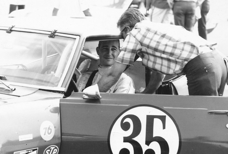

    The Gardner Camaro didn't have the wedged nose. I believe that was an old 1967 Bill Brown car, a very early Trans-Am car before they started wedging the noses.
    But the Penske Camaros definitely had it done in 1968 and '69. Here is one of the 1968 Penske Camaros pictured in 1970 with then owner Craig Murray. I believe they took a slice out of the radiator support panel and then tilted all the front sheet metal forward, then repaired the rear section of the front fenders so it didn't show.
    You can see in this shot the huge gap at the top rear of the panel where it doesn't meet up. I assume the panel was replaced at some stage but not modified correctly.

    The Gardner Camaro wouldn't have had the drooped nose in the Trans-Am when raced by Brown. That was really only something the factory teams did, and it didn't begin until 1968. There was a lot of work involved in doing it, only the big pro teams could do it. Its possible the SCA Freight team could have drooped the nose, but its pretty unlikely. One of the reasons for drooping the nose was to aid top speed, but as the British Saloon Car Championship rules allowed larger engines and more horsepower than the Trans-Am, straight line speed probably wasn't an issue. The factory Trans-Am teams were always looking for any tiny advantage because they all had 5 litre engines and roughly the same horsepower, but that wasn't an issue for the V8 cars in the BSCC.

    Thats right Dale. I think it might have been Tom McIntyre who told me how his Penske Camaro was done. No need to go cutting up the fenders. The whole nose including fenders, bonnet, and front valance all tilt down at the front. The only issue is that it creates a small gap at the top rear of the fenders, and the bottom rear of the fenders overlaps the lower bodywork around the doors. That just needs to be trimmed and a small section of metal added at the top to fill the gap. Looks nice when its done and everything looks in proportion.

    I also read in another article regarding the nose lowering, that the front radiator panel was sectioned 1 inch and the inner fenders were wedged back from the radiator panel. So the gap occurred in the rear top of the fender and also the lower back edges of the fenders were trimmed, as Steve explained.
